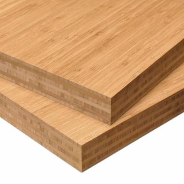

As bamboo plywood becomes more widely used in architecture, furniture production, and interior construction, questions about its performance under fire conditions have gained importance. Builders, designers, and inspectors want clear, reliable information on how bamboo plywood behaves when exposed to flame, heat, and sustained combustion. With many engineered materials on the market, fire‑resistance data helps determine where bamboo plywood can be specified safely and how it compares to other wood‑based products.
Understanding the fire performance of bamboo plywood requires looking at standardized laboratory tests, the structure of the material itself, and how treatments can modify its behavior. While bamboo is a natural material and therefore combustible, engineered bamboo plywood often demonstrates predictable and sometimes favorable fire‑resistance characteristics when tested under certified conditions. The following sections explore what those tests reveal and how manufacturers, builders, and code officials interpret the results.
The Nature of Bamboo Plywood and Its Combustion Behavior
Bamboo plywood is made from strips or slats of bamboo that are kiln‑dried, laminated, and pressed into dense panels. This manufacturing process produces a material that differs from both solid bamboo culms and traditional hardwood plywood.
Several structural factors affect how bamboo plywood responds to fire:
• The density of the laminated panels
• The adhesives used in the pressing process
• The uniformity of the fiber arrangement
• The moisture content during testing
These variables influence ignition temperature, burn rate, smoke development, and flame spread. Because of its density and cross‑laminated configuration, bamboo plywood typically burns more slowly than softer woods and tends to char in a controlled manner. Charring can help protect the inner layers, slowing further combustion—an effect seen in many dense wood products.
Standard Fire Tests Used for Bamboo Plywood
Manufacturers and independent laboratories use well‑established tests to assess the performance of bamboo plywood under fire conditions. While protocols differ by region, several tests appear frequently in technical documentation.
ASTM E84: Surface Burning Characteristics Test
Often referred to as the “tunnel test,” ASTM E84 measures two main factors:
• Flame Spread Index (FSI)
• Smoke Developed Index (SDI)
In this test, a horizontal sample is exposed to controlled flame within a closed chamber. The resulting FSI and SDI numbers determine how quickly fire travels across the surface and how much smoke the material produces.
Bamboo plywood commonly falls within ranges similar to dense hardwoods. Untreated samples may receive moderate flame spread ratings, while treated versions often achieve Class A ratings depending on thickness and finish.
ASTM E1354: Cone Calorimeter Test
This test evaluates heat release rate, mass loss, and ignition time. A cone calorimeter directs radiant heat onto a sample, simulating early‑stage fire exposure.
Key metrics include:
• Time to ignition
• Peak heat release rate
• Total heat release
• Smoke production
Because bamboo plywood has high density, ignition may take slightly longer compared to lower‑density species. The heat release data helps engineers model how the material contributes to fire growth in different installations.
EN 13501‑1: Euroclass Reaction‑to‑Fire Classification
European markets commonly use this test to classify materials into categories ranging from A1 (non‑combustible) to F (no performance requirements). Bamboo plywood typically falls into Class C or D in untreated form, depending on coating and panel thickness. Fire‑retardant treatments can improve results to Class B for certain products.
Bunsen Burner and Small‑Scale Tests
Manufacturers sometimes conduct small‑scale flammability tests to evaluate:
• Charring depth
• Self‑extinguishing tendencies
• Ignition behavior under direct flame
While not always used for certification, these tests offer insight into real‑world scenarios, such as accidental flaming contact or ignition from nearby heat sources.
What the Test Data Suggests
When reviewing results across multiple studies and product lines, several consistent patterns emerge regarding bamboo plywood’s fire performance.
1. Bamboo Plywood Burns Predictably
Engineered bamboo tends to char evenly and maintain structural coherence longer than many low‑density woods. The char layer insulates underlying material, slowing heat penetration. This predictability is useful in fire modeling, where consistent behavior supports reliable calculations.
2. Thickness Increases Fire Resistance
Thicker bamboo panels demonstrate better performance in virtually all fire tests. More mass means slower heat transfer, resulting in longer ignition times, lower heat release, and reduced flame spread. For applications requiring enhanced fire behavior, thicker sections or laminated constructions are often preferred.
3. Adhesive Systems Influence Performance
Modern bamboo plywood often uses low‑emission adhesives that comply with environmental requirements. These adhesives typically do not drastically alter fire behavior, though some resins may contribute small amounts of smoke. High‑quality manufacturing tends to improve consistency in burn characteristics.
4. Surface Coatings Make a Noticeable Difference
Clear finishes, stains, and protective coatings influence test results. Some coatings may slightly increase surface ignition potential, while others—especially those designed for fire retardance—improve flame spread ratings significantly. Many fire‑rated bamboo plywood products use coatings that meet Class A surface requirements.
5. Fire‑Retardant Treatments Expand Architectural Use
Pressure‑impregnated fire‑retardant treatments or fire‑rated surface coatings can improve bamboo plywood’s performance to meet strict building codes. These treatments typically help:
• Reduce flame spread
• Lower smoke production
• Delay ignition
However, treatments can affect the color and texture of the material, so architects must balance performance with aesthetic goals.
How Architects and Builders Interpret Fire Test Results
Although bamboo plywood is combustible, test data helps clarify where and how the material can be used safely. Professionals consider several factors when reviewing fire‑resistance information.
Interior vs. Exterior Use
Interior applications—such as wall paneling, ceilings, and cabinetry—often rely on surface flame‑spread ratings. Class A or B ratings allow bamboo plywood to be used in many commercial interiors when properly treated.
For exterior applications, weather exposure adds complexity. Moisture can influence fire‑retardant coatings, so products specifically rated for outdoor use should be selected.
Load‑Bearing Applications
Fire tests for structural use focus on how long a material maintains load capacity under fire exposure. Engineered bamboo beams and panels often undergo additional testing to evaluate charring rates and structural integrity under high heat. While bamboo plywood is not typically used as a primary structural panel in fire‑rated assemblies, laminated bamboo elements sometimes support structural applications when tested as part of a complete system.
Integration With Other Materials
Bamboo plywood is frequently used alongside drywall, steel, insulation, and other components that influence fire performance. For example:
• A fire‑rated gypsum layer can protect bamboo plywood in wall systems.
• Metal backing plates may improve fire performance in cabinetry.
• Mineral wool insulation can reduce heat transfer behind bamboo panels.
Understanding system‑level behavior ensures that the entire assembly performs as intended rather than relying on the plywood alone.
Compliance With Codes and Certifications
Building codes specify minimum fire‑performance requirements for interior finishes, structural components, and partitions. Architects look for:
• ASTM E84 Class A or B ratings
• EN 13501‑1 Euroclass ratings
• Certification from reputable testing laboratories
When bamboo plywood meets or exceeds these standards, it becomes easier to approve for commercial and residential projects.
Improving the Fire Performance of Bamboo Plywood
Manufacturers and fabricators use several approaches to enhance fire behavior. These improvements are especially important for public spaces, commercial interiors, and institutional buildings.
Fire‑Retardant Coatings
Clear or tinted coatings can reduce flame spread significantly. These coatings often:
• Form a protective layer when heated
• Expand to create a thermal barrier
• Reduce smoke production
Because coatings may influence appearance, sample testing is essential before final selection.
Pressure‑Treated Panels
Some bamboo plywood is pressure‑impregnated with fire‑retardant chemicals. These products often achieve higher fire ratings than surface‑coated versions, though they may have a slightly altered color or texture. They are commonly used in applications where fire codes are particularly strict.
Multi‑Layered Assemblies
Combining bamboo plywood with non‑combustible materials can improve performance without altering the plywood itself. Examples include:
• Using fire‑rated gypsum board behind bamboo paneling
• Incorporating non‑combustible acoustic substrates
• Installing bamboo within aluminum or steel framing systems
This approach preserves aesthetic qualities while adding layers of protection.
Real‑World Performance and Design Considerations
Beyond laboratory tests, real‑world conditions influence how bamboo plywood behaves in fire situations. Several practical considerations help guide safe and effective use:
• Ventilation and airflow can accelerate or limit flame spread.
• Installation orientation—horizontal, vertical, or ceiling mounted—changes exposure patterns.
• Unfinished edges may ignite more readily and require careful detailing.
• Maintenance of fire‑retardant coatings affects long‑term performance.
Manufacturers generally provide guidance on installation, coating reapplication intervals, and compatibility with adhesives and fasteners to maintain fire‑resistant properties.
How Fire Performance Shapes Applications
Test results influence how designers specify bamboo plywood across various settings.
Commercial Interiors
Restaurants, offices, hotels, and retail spaces often require finishes with low flame spread and controlled smoke development. Fire‑rated bamboo plywood provides a natural aesthetic while meeting safety requirements. Wall panels, ceiling systems, and built‑ins are common applications.
Public Buildings
Libraries, museums, educational facilities, and other public structures often prioritize materials that balance warmth with safety. With proper fire‑retardant treatments, bamboo plywood meets these expectations while offering a uniform, polished look.
Residential Projects
Bamboo plywood is widely used in homes for cabinetry, wall treatments, furniture, and stair components. While fire‑retardant treatments may not always be required, understanding its natural fire performance helps homeowners make informed decisions.
Hospitality and Wellness Spaces
Spas, resorts, and boutique hotels often use bamboo plywood for its calming aesthetic and tactile qualities. Fire‑rated versions allow these designs to remain compliant without sacrificing atmosphere.
Final Thoughts
The fire resistance of bamboo plywood reflects a combination of material density, engineered construction, and the use of specialized treatments. Standardized tests provide clear insight into flame spread, ignition behavior, heat release, and smoke development. While bamboo plywood is combustible, its performance is predictable, and numerous treatments and assembly methods allow it to meet strict building requirements.
As architectural and interior projects continue to incorporate natural materials, understanding fire performance remains essential. Bamboo plywood offers a balance of beauty, reliability, and versatility that aligns well with modern construction needs.
